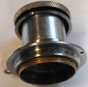

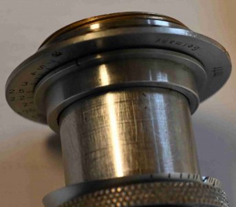

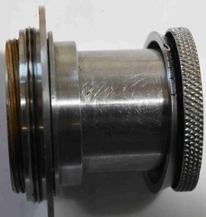

I have an Elmar 50/3.5 whose focus is truly stuck, a bit short of infinity.
I've cleaned the accessible threads, and I've soaked it in naptha for several days, and now I've had it in penetrating oil for a few days.
Still will not budge. Does not look bent. I took the infinity lock off.
What to do when it is stuck so solid?
Did it ever work? Can you post some pictures?
It sounds like the threads might be damaged. The 5cm F3.5 Elmar is a simple single-helical design. If it was old lubricant, what you did should loosen it.
About all I can think of is to try some rubber pads to get a good grip.
Here it is. Infinity lock is off. Stop[s are off. The distance ring is pried off and loose.
I've used all the force I can with a rubber sheet.

The only situations I've had: 1) cross threaded, but I doubt that is the problem here. The threads are coarse. 2) Something jammed into the threads. I have seen set screws get into the mechanism. You can try solvents, and heating the metal.
If it is a screw or something else jammed in- force is about the only thing I can think of that works.

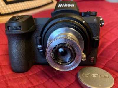

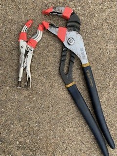

Success. It took a lot of force. I had to use big wrenches with rubberized jaws.
A bunch of solid green stuff is what had glued them together.
I lubed with vacuum grease left over from my ultracentrifuge days.
The hardest part was getting the barrel back into the helicoid over the light baffling felt.
Thanks for the help.
