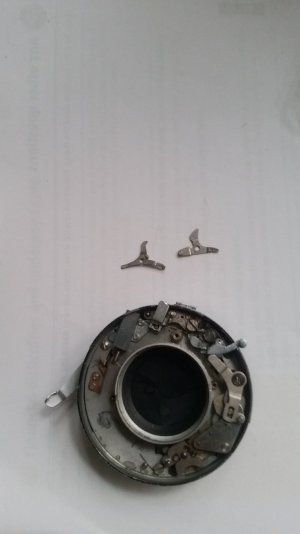

Hello, just got an " untested" selfix 820. The epsilon shutter would not cock ( interlock tab sheared off). I have made a number of repairs and it now fires more or less accurately on all setting except B and T. I must have taken and cleaned those parts many times but the shutter always closes immediately. There seems to be no position where the B/t arms would arrest the shutter and still be moved by the trigger to close the shutter. I have seen John Hanckocks pages on flickr concerning the epsilon shutter but think I need a workshop manual to tell me where each arm (b and t ) need to be at any given time during the firing process. Does anyone know where a manual could be found? I attach pic of the shutter with the b and t arms removed
