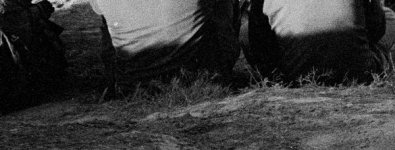

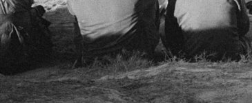

I am trying to figure out why I can't get proper shadows from my CS 5000 when I can get them from my V500.
The resolution of the Nikon is much better, but the shadows look crappy.
I use vuescan, and tried what seems to be any combination of RAW saving/TIFF/with and without Scanhancer, etc..
I am joining two samples. First one is the CS, second the V500.
Any suggestion?
To me it looks like the firs one has more shadow detail and resolution/sharpness. Because of that the grain shows up more (just quessing why it might look crappy to you). It would be trivial to darken the shadows in post processing (or even in scanning software) to match the second one if you want them like that.
I'm not a pro or anything though... Just wondering why you like the shadows better on the second sample.
I should have added that the histograms are very different in the blacks:
The Epson goes down nicely to zero, while the one from Nikon has a peak at the lowest values, which I understand, means that clipping is occuring
I personally like the look of the coolscan shadows more - they're crisper with no less detail on my monitor...
To me the Coolscan looks better, the shadows are a tad darker of course, but for me, look as nice or better. You could try scanning as a positive, or if you've got Vuescan, try multiple passes.

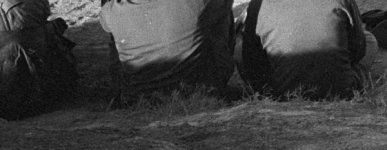

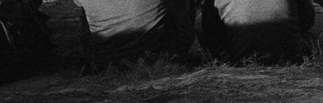

OK, last news from the front:
It seems at least part of the problem is Vuescan:
When I scan with Nikonscan, I get what I feel are better shadows, the histograms look nice in the dark areas and using scanhancer doesn't seem to impact the scan at all. I'll try to learn the software (never used it), design a workflow for digital negs, and, hopefully, back again to those 80 scans I need to do...:bang:
