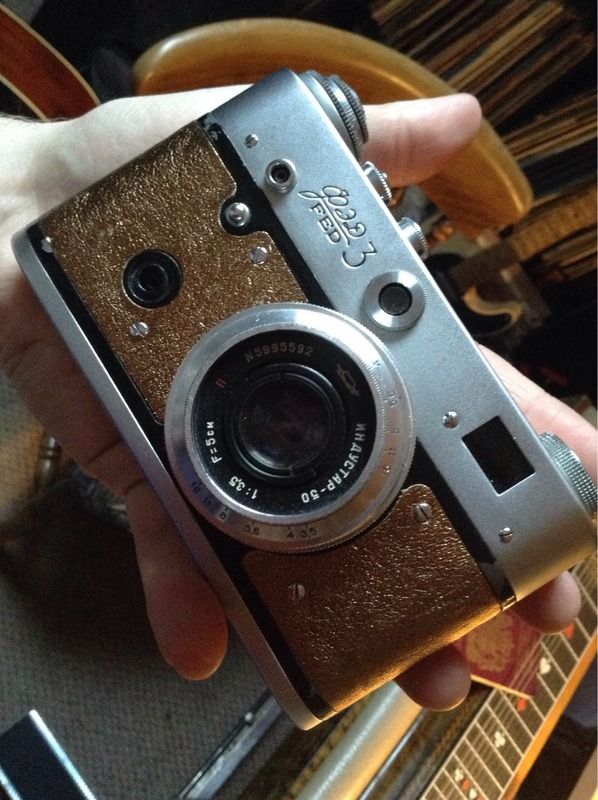

I'm new on here and thought I'd start with my Fed3. I bought a lovely gold Fed3 last year and loved everything about it. I used it a few times but, had to retire it as out of a roll of 24, only about 16 would come out and some of those had black blurred edges to them and it seemed to get so unpredictable (I now know it's a shutter problem, most likely 250 and 500 speeds ) . Also light leaks started to appear and I went back to my Nikon FG20.

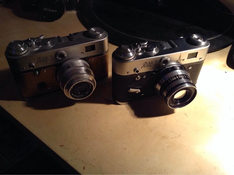

So fast forward to last week and my Girlfriend surprised me with a new "fully serviced" fed 3 from Ukraine. I was delighted! But, realised it was far from serviced.
1)shutter speed selector knob in the wrong place. (Fixed)
2) self time sticking and then not firing if it makes it.
3) light leaks in the curtain! Again!!

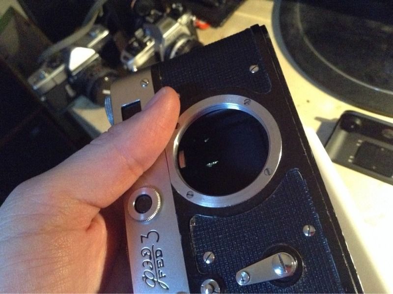

So first of all I wanted to ask advice on the light leaks. I found a how to on the Lomography site using white glue and black plastic paint (which I haven't found yet). My problem is the shutter curtain has deteriorated right on the edge of where it wraps onto the spool. I'm concerned to get glue in there as it'll jam the whole thing up so, I thought of repairing it from the back.

For SMALL pinholes or thinned curtains you can use the black paint used to paint fabric or T-shirts. Let it dry for 24 hours.
Keep in mind that: 1)This is a temporary fix 2) It may not work in major lightleaks like the one you posted.

It is so cheap that you should not bother with it and get another one. It is so easy to fix that if you have another one you can get the curtains from it.
