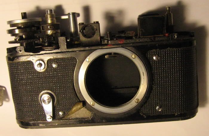

The camera is ugly but it has no dents, it seems to have stayed unused for many years. Front view, ready to start working into the shutter.

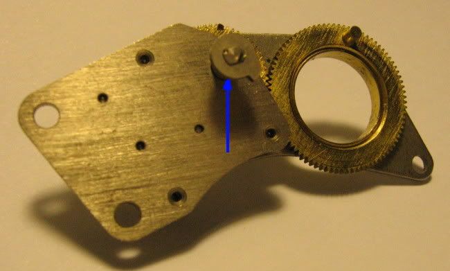

After inspection and making the shutter work in the slow speeds, it was clear that the second curtain was not being released as it should by the little cam below the slow speeds timer (blue arrow):
I'm not sure of the cause of this problem. The cam was sitting where it should and contacted the second curtain's catch in what seems the right place, but it could not move the catch; helping the gears in the direction of their normal movement did release the catch.
What could be the cause? Lack of adjustment, something bent, dirty timer gears, too little force of the spring in the timer? I took the timer out in order to take a closer look at the shutter release mechanism (I know I'm in for a lot of fun to put it back again):
In the picture above the shutter is set at 1/125, just to show the parts. The second curtain catch, pointed by the blue arrow, catches a black metal pawl (red arrow) in the rotating speed selector assembly. I'm surprised by the sharp look of the catch's end - is it normal? Moving the catch clockwise in order to release the second curtain, which is the cam's job, takes what seems to me quite a bit of force for these small mechanisms. Maybe curtain tension is too much; in any case it is balanced with the second curtain, or so it looks in TV tests.
Besides, I thought that with the timer out faster speeds should work normally, but they don't - the pawl is stopped by the second curtain's catch. Maybe the cam holds the catch in the right position only when the timer is in place?
Is there any adjustment to be made on the second curtain's catch (pointed by blue arrow in last picture) with the timer out?

The faster speeds won't work with the timer escapement removed - the cam keeps the catch out of the way only when the timer has run down (in its "resting" position). I'd see how it goes after cleaning the escapement and I'd suggest that you oil it VERY sparingly with some thin clock oil. It's possible to increase the spring tension if it still fails to trip the 2nd curtain after this. There's not really any adjustment possible in the catch.
Slow speeds are now working, after soaking the slow speeds timer in solvent and installing it back. Thanks Wolves for the tip!
In order to install the timer I found it easier to set the shutter to 1/2 s, wind the gear, then install in such a way that the pin in the ring gear comes to rest with the top of the speed selector blade.
After installing the timer I found that fast speeds seemed to expose only about 3/4 of the frame. The right side, as seen from the back, was always dark. Besides, all speeds from 1/60 to 1/500 seemed to give the same illumination. It turned out that, when setting back the timer, the spring holding the B cam (just below the red arrow above) had come loose. Once fit in place again, all of the shutter speeds work fine.
