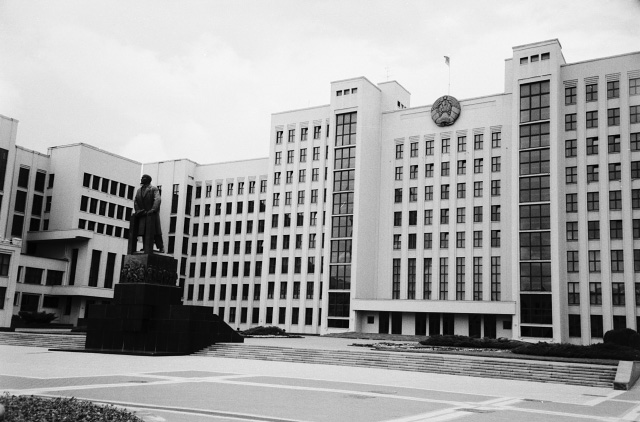

Below is an old TMax 400 in Rodinal (not the lowest grain combo), and a 200% blowup fragment. You can clearly see my 3600 DPI scan does not approach to resolve all the detail (and I confirm that after checking the neg with microscope).
