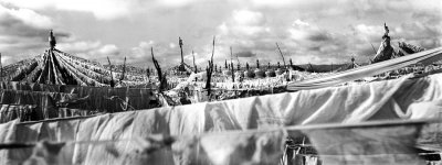

I was shooting some stuff in the 4000-5000 meter area a few months ago, if your subjects are not more then a couple of miles away a uv filter will help, if they are father and you are shooting bw, take mike's advice with the red, I shot some photos with a red (for some reason when I do my skies never go black, I must be doing something wrong) and it was great.
First shot with my yashica gsn an a run of the mill hoya uv filter, the second was with my modified kodak 3a pocket camera and a red filter held in front of the lens.
