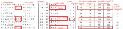

I bought an FC yesterday and did some searching about this little camera. I happened to see a page from a Japanese optic book on someone's blog, with some information about the 60-70s fixed lens rangefinders. I highlighted the lines about Yashica CC, GX ,and FC, and tried my best to resolve the Japanese with my Chinese language skill, then translate them roughly to English.
On the Internet you're likely to see FC's lens described as a "4 elements in 3 group, Tessar". But here in this book it's described as a "4 elements in 4 group, modified Tessar". Also the resolution of FC's lens is not too much behind its two cousins.
Many other compact rangefinders are listed on the page too. Quite interesting to read/guess.

nukecoke, your table is very interesting. Can anyone translate the first line, what camera is that?
nukecoke
⚛Yashica
I believe it's Minolta HI-MATIC E with Gauss type lens.
