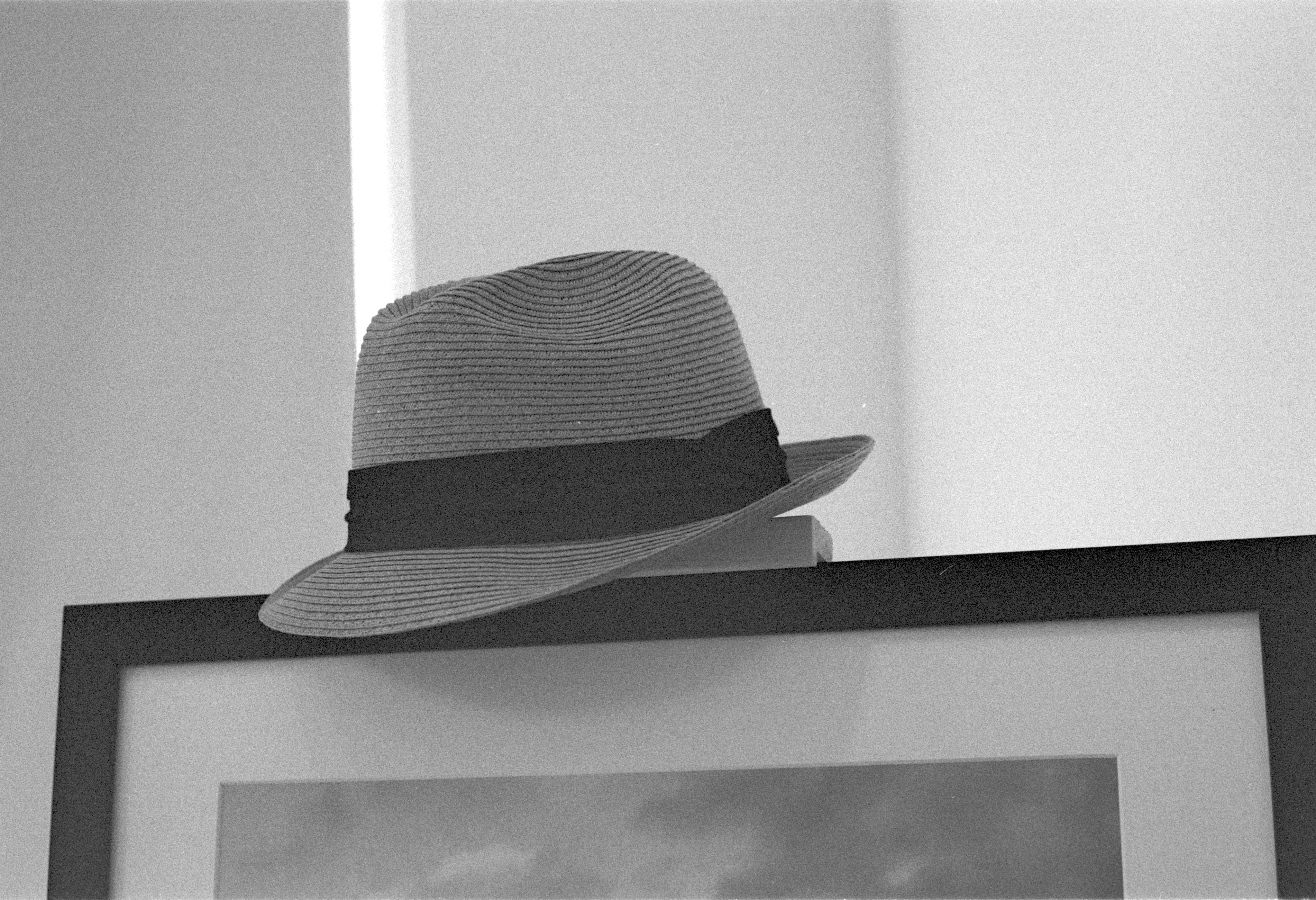

As and you shall receive
Here's a full size unsharpened copy of the "hat" photo attached below.
This was at f8 or f11 (I'm leaning to f8 though) on the collapsible cron.
Kaiyen, I do agree with you that the differences in low/available light would be interesting and really test what the film will look like - I will look to get some of that soon I hope. The closest I could get was the second attached photo which was shot at f4.5 on the 15mm @ about 1/15.

I'd like to get one of the shots in to print at some point - hopefully sooner rather than later since I'd like to use this method/film for an upcoming wedding I have to shoot - Sad thing is, it will be printed by a minilab digitally rather than "properly" on quality paper etc. But at least I should be able to have some idea.
