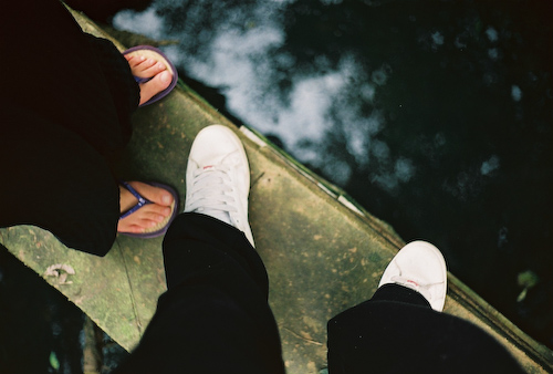

The third photo (with the feet above water) is very lovely.

Yeah, I just hope the CLA won't cost twice as much as the camera did. I will try and look at yashica-guy.com to see if I can make an operation myself.The third photo (with the feet above water) is very lovely.
