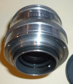

It is a Jupiter 8 that was on a Zorki4.
I ran a test roll last night and havent yet developed it to see if the distances or RF are right
At infinity I have 7.83mm in the Elmar but only 7.76mm on the J8.
Elmar (10ft) 3.05m 6.68mm J8 3m 6.60

PS Found SonnarBrian's comments on this thread, I guess this is a waste.
Most Russian lenses can be adjusted to work decently well on a Leica, especially for Film where the tolerances have a bit more leeway.
However I do not find the strange half drilled hole in the bottom of that Jupiter-8 to be confidence inspiring. This lens most likely has some inexpert repair behind it.
Now I sadly forgot how exactly the Jupiter-8 of this generation goes together as I previously mainly repaired the ones which still had a focus nub. But if the RF cam was just misthread (the bottom does not look ground off luckily) it should be fixable. Once repaired, even without adjusting the lens in the way that Brian details it should be fine in daylight for further away subjects, but closer-in will get dicey.
However since the Russians played it quite loose with the tolerances to their (non Leica standard) you might get lucky and have a lens that focuses very close to Leica already.

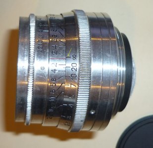

Edit: The aperture index also looks off. It should use the distance focus mark as aperture index IIRC. So it seems very likely that this lens has a bad repair behind it.
Aperture is way off- so someone tried to shim it. I've seen worse work on drilling holes for screws. The RF cam does not rotate when focusing. That means you can add a layer of tape to build it up. I've done that on this version of the J-8. The next step is to properly shim the lens, and re-index the aperture.
Oh well, I got it in a Zorki4 camera I found at GoodWilll some years ago. Camera never worked so I had it in the "paperweight" box and only remembered when I got the Leica IIIf.
It's unfortunate, the J8 and J3 are very good in Contax mount.
Glass is clean, focusing ring was stiff, but has become looser with exercise, and you;re right the aperture index is off.
That hole was a screw on the other side that "guides the lens" and I assume it also serves as a physical stop.
I will try Brian's solution with some mylar tape (0.08mm difference) after I develop the test roll.
