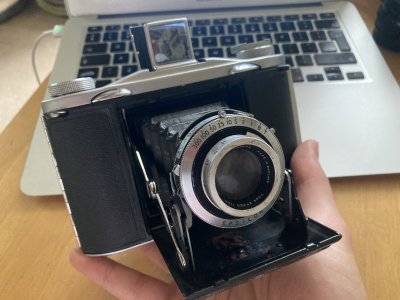

Another option would be the Ensign Selfix folders - a fair bit cheaper than the Zeiss or Voigtlander folders, and the pop-up Albada finders on the later Selfix models are really quite nice. I had the 16-20 for a bit a while back, but never really gelled with the 645 format. I have a (6x6) 12-20 in my office that needs a clean up before I can use it, but it's a charming little thing. It has an unusual lens release and shutter button design:
Those shiny nubs above the bellows are pushed outwards, not down, to unfold the camera (on the left as you hold it) and fire the shutter (on the right). I imagine that might be a bit more stable in use than your regular downwards shutter release, but I won't know for certain until it's all been cleaned up a bit.
The 16-20 had a conventional shutter release button in comparison... but there was a spike hidden inside it that stabbed you in the finger if you hadn't cocked the shutter!
Here's the view through the viewfinder. There's not really that much of a gap around the framelines - that's all due to slamming the wide lens of an iPhone camera into it as tightly as possible, but there is a decent bit of space around, even when wearing glasses. One thing I do find interesting is the circular mark within the framelines; I can't tell if that's intentional (to indicate the way a lot of photos were mounted in circular frames) or just a side-effect of the circular eyepiece on mine being incredibly filthy. My guess is the former, not the latter.
