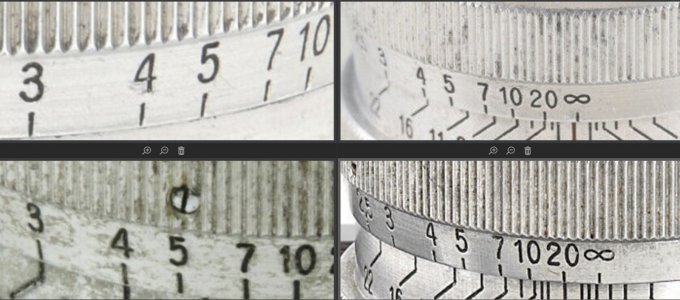

By accident I stumbled over some detail that might help to date LTM Sonnar 5cm f/1,5. I noticed different fonts that where used at different versions.
It is a theory for now but I would like to share my findings. You can differentiate the origin of a LTM Sonnar 5cm f/1,5 through looking at the focus scale especially the numbers 3, 4, 5, 7.
CZJ wartime Sonnar 5cm f/1,5 T (authentic / 1940+)
prewar Sonnar 5cm f/1,5 T (red dot / transition / 1944+)
KMZ Jupiter-3 5cm f/1,5 P (1951+)
It is easy to see that the 4 changes its appearance over those periods. The 7 is also a very good indicator of the origin of the lens. While during war the seven hat not small caps and a light bow in the long side, it got small caps in the transition time after the war and the long side changed to a straight line. The Soviet 7 only consists of 2 straight lines.
I found some interesting observations after noticing the numbers of the focusing scale.
Here is one with an inverted focusing scale -> Transition fonts
Then there is one of Skyllaneys refurbished lenses -> Transition fonts
Then there is one of those rare East German CZJ LTM Sonnars -> Transition fonts
And then there is my own LTM wartime CZJ Sonnar 5cm f/1,5 -> unique 3 & 4 🙈 🥲
Damn, now I have to find a better example for the overview. More money to burn...
