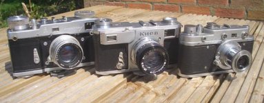

The Leningrad has a very clear viewfinder. It is certainly the best of these three.
