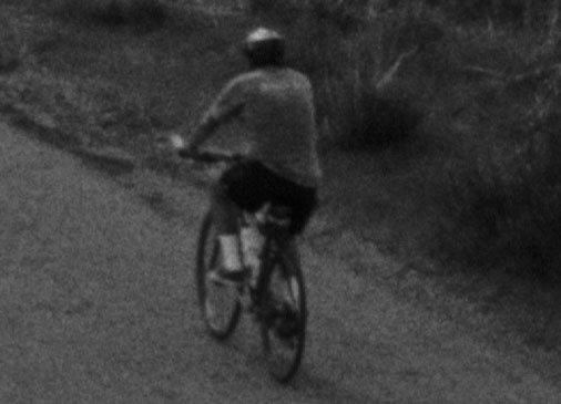

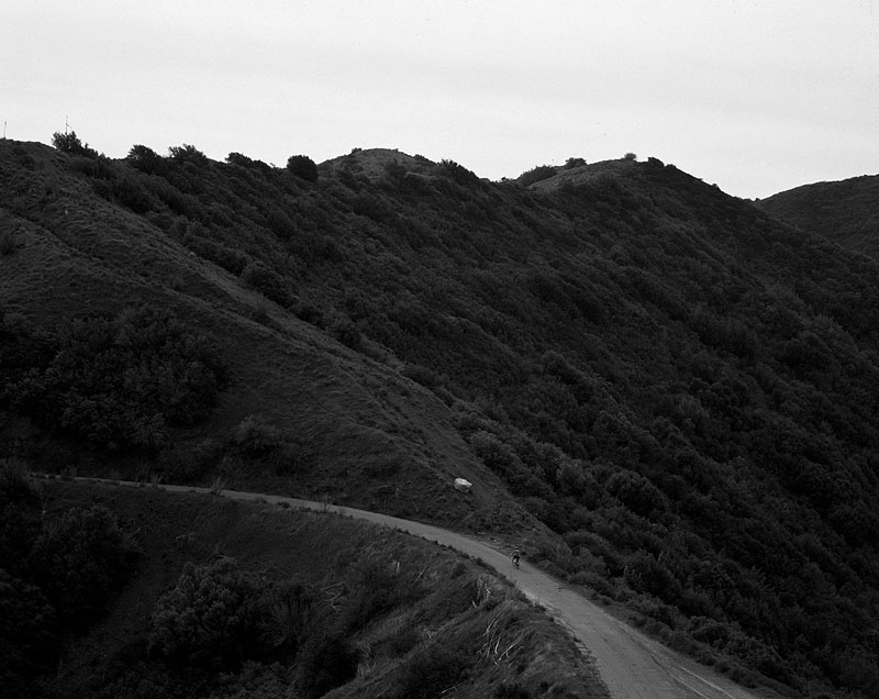

I was screwing around the other night, scanning some negatives, and I decided to tear one apart under high magnification. Really high magnification.
The following page, though exhibiting no great artistic merit, illustrates just what a 65mm f/5.6 Fujinon is capable of picking up - even with relatively careless shooting, developing, and scanning. I'm sorry about the typos on the page. It was late.
http://www.dantestella.com/technical/gsw690iii-res.html
When you drill down into stuff like this, you can see how modern medium-format wideangle lenses perform. I think it's like looking at a 35mm negative, just bigger. But draw your own conclusions.

Agreed on the amazing results in that picture. May I ask, in addition to being made "with relatively careless shooting, developing, and scanning," was this picture also taken through the glass of a window, or were you on the roof of a building or similar?

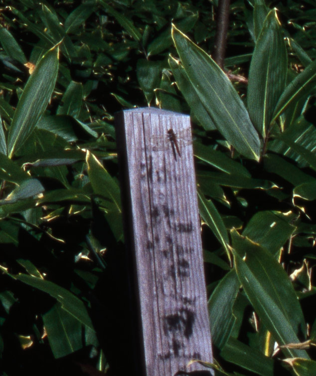

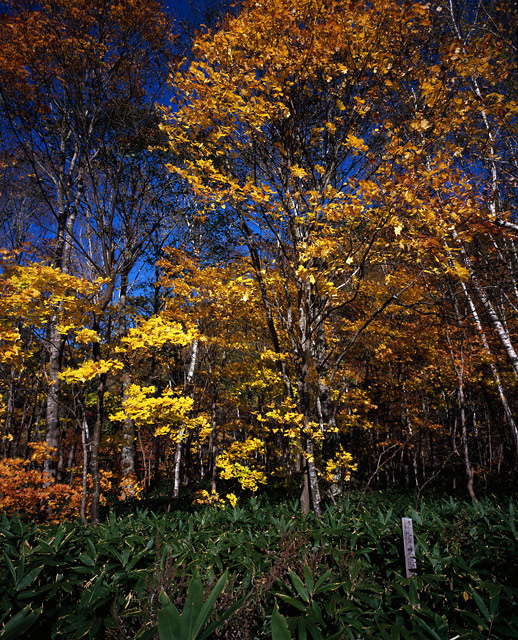

Several years ago I noticed a similar thing to you. I took this shot in the mountains one day...the film was Agfa Scala and the scanner a Minolta Scan Multi Pro, no sharpening. Like yours, these were not really planned images...I just took these normally on normal films, probably handheld, and scanned them with my scanner at the time. But they have a whole lot of detail.
100%
I believe this was the 80mm lens. I noticed a similar effect with the 43mm when I was in Japan:
Either way, these modern Mamiya and Fuji 120 rangefinders are absurd. I also shoot 4x5 and usually the Mamiya is sharper, if only because the whole body is more rigid and plane parallel than my field camera, the lenses are better at wider apertures, and it is less sensitive to depth of field, camera shake etc etc. The are outstanding image-makers.
