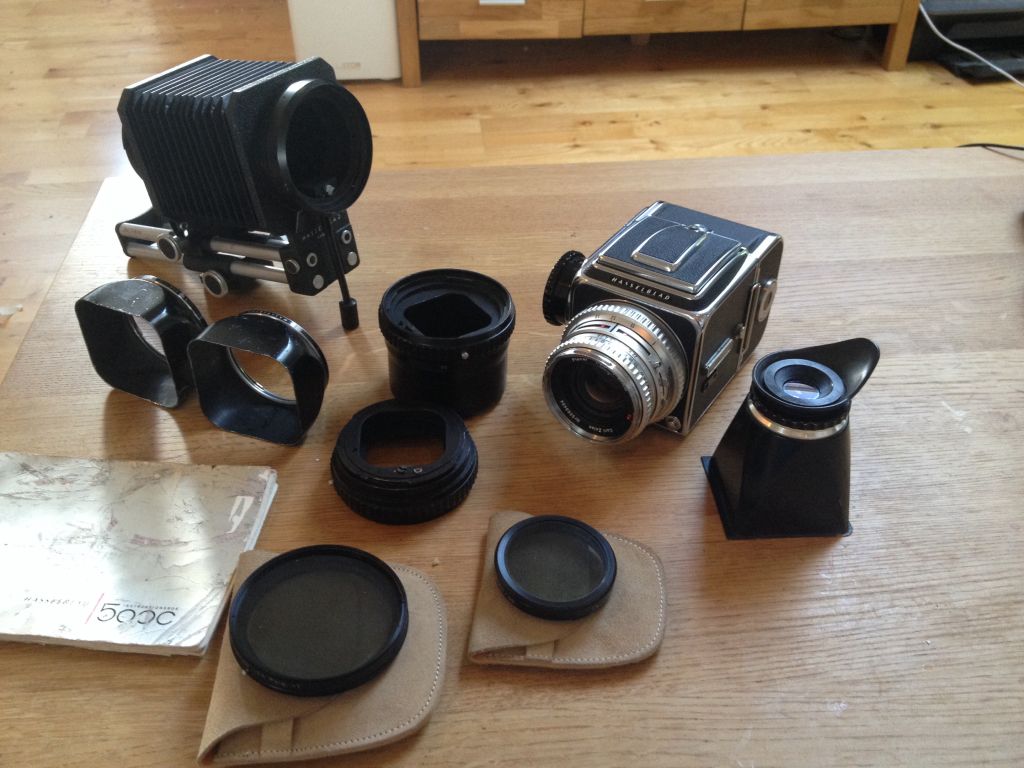

I bought a hasselblad 500C on auction a few days ago, was a kit with hasselblad bag, bellows, two extention tubes, filters.
Seems to be from 1969, serialnumber starts with TE and the planar optics is,marked with a T* so it is multicoated ???
Is the bellows set complete?

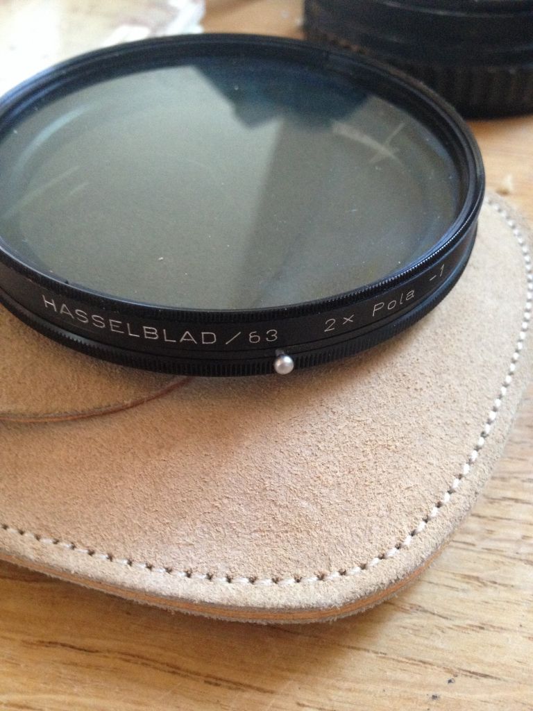

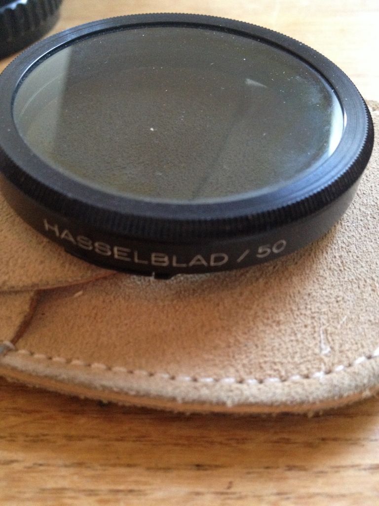

What kind of filters did i get, says hasselblad 50 2*pola -1 on one and on the otherone it seems to be the same but hasselblad 63, dont think I have anywhere it fits.
How can I use the eyecup, I guess I cant remove the existing viewfinder as it is a 500C???

Welcome to the forum. The 500C is a great camera. If you take the back off, the waist level finder will slide out and the other finder can be put in. Enjoy. Joe
I've had a ball with my 500c. Don't forget to remove the darkslide before pressing the release, or to wind the film on before changing lenses (which cocks the shutter - has to be cocked to attach a lens). The other oddity is if you have the shutter cocked and change backs with the new back not wound on. You have to take off the back, press the shutter release, re-attach the back and then wind on. It all makes sense once you figure out how it works, but all the above errors caught me out at least once when I first got the camera. Then there were the C12 backs and how to load them....

The 63 is for a lens that uses Series Vlll filters like the 50mm C lens.
They're both polarizing filters. If you look at a body of water with glare and rotate the glass, you can watch the effect.
The -1 is the amount that the light reaching the film is reduced by. -1 = add more exposure(1 stop).
Other filters may show 2X for the same adjustment.

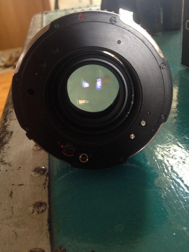

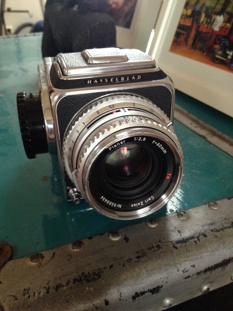

Can you take a closer photo of the front and rear elements of the 80 planar?
Never seen chrome lenses with T*. Was curious if someone swapped the glass from a black one into a chrome barrel, or just the name ring
Hi, sure np.
Seems to be in good condition.
Seems like the previouse owner was the swedish police, seems like they took very good care of it. :)

I am in awe of the condition!
I've owned several T* chrome lenses. There's nothing rare about them.
