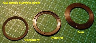

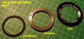

It would seem almost impossible for the front element to move around because it sits (tightly) in a recess. On top of the lens is a circle of what seems like thin cardboard-it's probably to protect the lens from the retaining ring. The retaining ring is screwed down on the element so the cardboard ring is trapped in a recess-the flat side of this retaining ring faces outward. The trim ring, with the identifying words/numbers, screws in last. It doesn't really have anything to do with holding the front element in place. Your lens seems to have the cardboard ring floating around. Should be an easy fix.
Hey Victor,
Thanks for your help! I reallly appreciate you posting those pictures and giving me some diagnosis... I guess I didn't look at the lens close enough, but it definitely could be the cardboard disk you mention & not the whole element floating around in there... Does that mean the retaining ring must be loose as well? Hopefully it just needs to be tightened a little... If the screws just hold the trim ring on I shouldn't need to search out a replacement for the one that is missing?
From your picture the front retaining ring looks very similar to the one on the back of the front elements... hopefully removing this will help me clean up the haze issue...
Thanks again for all your help!
Peter

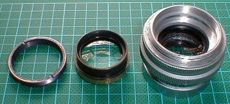

Here's the rear elements removed. The lens elements are a slip fit into the barrel and should be easy to remove after you remove the retaining ring. Similarly, the front element should pop out when you remove the retainer. Be very careful (gentle) when cleaning the haze because the inner surfaces are easily scratched. Also, when removing the front trim ring, don't stick anything metal in the tiny screw holes; you'll ruin the threads. I used a toothpick to gently push the ring loose (after removing the screws). Don't remove the two screws on the aperture ring; the blades will fall out.
