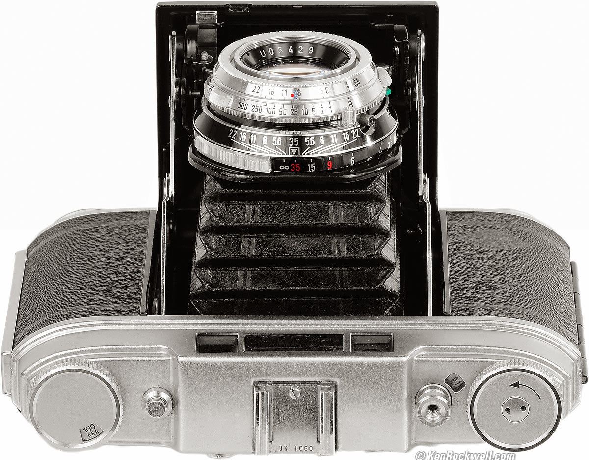

I have an Agfa Super Isolette that has a sluggish rangefinder action - that is, the follower for the RF cam attached to the lens moves more slowly than the lens being focused. Probably gummed up with many years of grease and just needs a scrub. Problem is, I can't seem to figure out how the top comes off.
I've successfully removed the wind knob and the screw underneath, as well as the accessory show cover and its hidden screw. Is the film reminder knob at the left of the camera supposed to come off? If so, how? A hidden screw under the front name plate (I hope not!). Anything else? :confused:
I took down the lens and helical the other day and got them working smoothly - this is the last thing I can't figure out. Thanks in advance!
For visual reference...
Take a look under the top of the film spool retaining shaft - which is directly under the film speed reminder. The shaft is slotted for removal with a screw driver.
Get a syringe with a tinyl hypodermic needle to a.) put a tiny droplet or two of Rosinol/naphtha on the RF mechanism for cleaning to see if it frees up - and - b.) to put a tiny droplet of lubricant onto the pivot point after cleaning.
Have fun keeping tracking of those tiny screws for the RF cover plate.

Blind Spark, I can't seem to remove that hot shoe blade covering the hidden screw. Of course I removed the visible screw but then can't seem to slide or pull that thing away? Anything I'm doing wrong ?

Sylvain, if you look at Hans' photo closely you'll see that the plate hooks over the front of the shoe, so you have to lift the three sections in order to get it moving towards the rear.
PF
PF
Oh indeed ! I just popped it out :)
