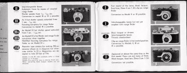

A person on a different forum came up with photos of two very similar examples, one IIIf in 40k s/n range, and one III s/n 4387... woohoo! Mystery solved
Thank you very much!

Lots of Leicias were upgraded e.g. such that if you are collector and want a IIc you will search long and hard, as they are almost all IIf, apart from the ones already on shelves, (e.g. the film did not run properly on IIc).
Flash and slow speed were a popular upgrade, they would probably have left the origional serial number, the flash PC connector appears anywhere on upgrades and probably would have been done a lot later than the slow speeds.
