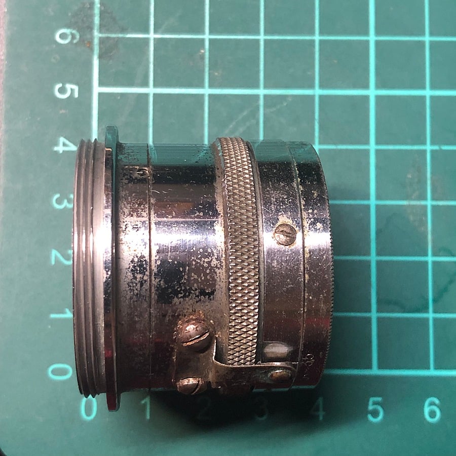

I have come across a very interesting variant of Nippon Kogaku enlarger lens Hermes 5.5cm f3.5, Nr. 55282
Its barrel is shortened, and the front element is swapped to “Nikkor” 7.5cm f4.5 No. 789.
(The grids in the pictures are in centimeters).
Hermes - 7.5cm f4.5 front element
Barrel shortened from regular Hermes
Front element
My first impression was “Who would have dared to cut the venerable Hermes barrel and swapped the front element!?”.
However, I gradually found out that this lens was sold alongside many prototype lenses such as 50cm (No.5001), 18cm f4.5 barrel lens (Nr. 1), Hansa Canon 50mm f4.5 lenses and lots of anaglyphic drafting machine projector lenses (3.7/4.35/4.4/4.5cm f18) used with aerial photos, all from the early 1930s and some components from military theodolite, suggesting the sale was from either former military lab inventory or an estate sale of Nippon Kogaku engineer.
Now it made more sense. During the late-1930s, a variant of Hermes must have been tested with 7.5cm lens.
Technically, this lens can be applied to close-up photography, so I have tried mounting on my RF bellows system using permacel tape and seemed to work fine, showing clear images on the reflex housing.
