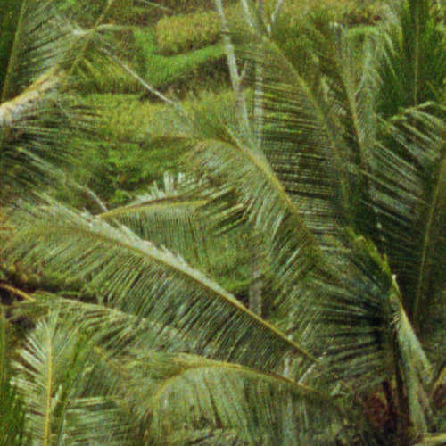

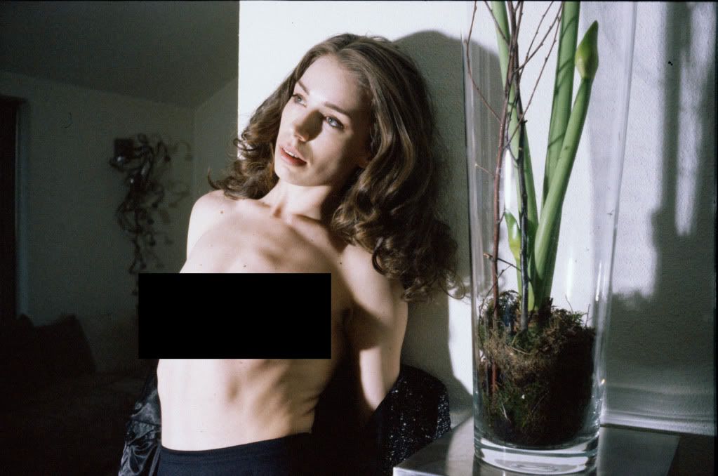

A good model, and you use old film. I don't understand...
I can only guess, but I would suspect the film or the scanning rather than the camera. Everything is fairly soft here.
I only had expired film to my disposal. This model I shot with a Fuji X100 as well. As I'm still in the 'getting to learn to shoot film' stage I played it safe with the X100.
Now, I also scanned a roll from a Yashica T5 and that was tack x10 sharp!

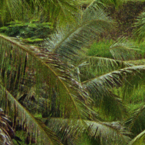

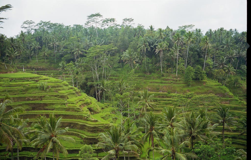

Here I have a shot that I edited quite a bit so its not the original file, also taken with the Hexar.
(also expired film, but Provia 100)
Those series show indeed that the lens is less sharp than the summicrons. So if you want sharpness/rendering as from a Leitz lens, ... I would say....go Leitz...

Not good tests. That's a wonderful model we almost saw enough of. I don't think the Hexar lens is so very sharp. In many situations it seems so sharp because of the high contrast. There are many contributors to perceived sharpness.
Sharpness is an effect of lens/film/development method/scanning etc
There could be any issue with any of these elements, hard to say what is wrong with your example. Hexar AF is as sharp as anyone would need and anyone who thinks they can see the difference between a Hexar AF and any non-asph is fooling themsleves.
Maybe you are pushing the film too much, or maybe indeed your lens might be faulty, who knows.
