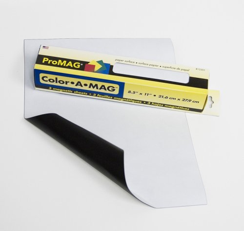

Ghe
Interesting, but because english is not my native language I do not understand what are "fridge-magnet type sheets". Could you please give me some more details? Sorry for stupid question and thanks in advance.

Dear Robert
I understand where you're coming from (my native language is not English either). It's this type of vinyl sheet that has magnetic particles incorporated into it. They're usually 1-2mm thick, black on one side and white (or other colors) on the other side. The reason they're sometimes called "fridge-magnets" is because you can print images on them and put them on the door of the refrigerator. Sometimes companies print funny advertising on magnetic sheets and give them away in the hope that people put them on their refrigerators for fun.
see:
http://ecx.images-amazon.com/images/I/413XofsVeiL.jpg
http://www.amazon.com/Magnetic-Sheet-Crafts-Home-Shop/dp/B000KZBMDO
