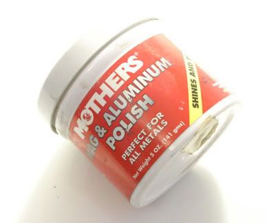

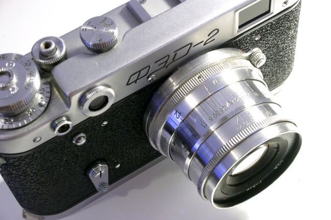

I've been using this aluminum polish for years. Cost about $5 from car auto stores. It works like magic. Take the dirtiest yellow looking Industar / Jupiter and makes it look chrome plated.
Please note that some Industars had a Varnish coating applied. Polish will not work on this surface.
Simply apply neatly with a Q-tip and polish away with a cloth.

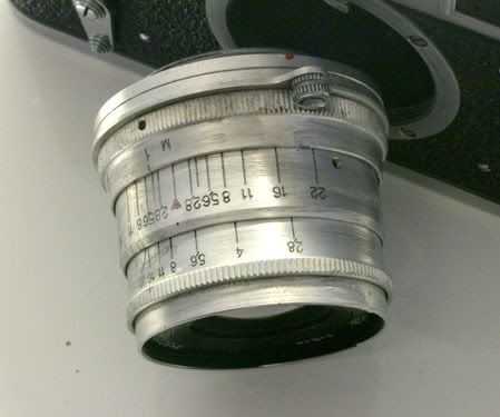

The Industar didn't look bad but I knew it could look better.

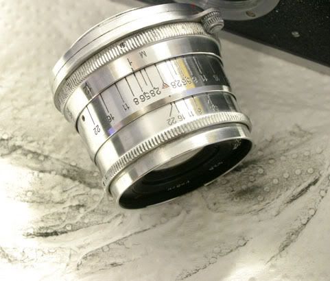

Polish applied: Has the consistency of toothpaste but make sure none creeps into the lens barrel.
When polishing you'll see black residue on your cloth keep wiping until this stops. One / Two applications is usually enough.

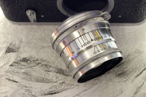

I didn't do a complete polish in this picture montage. But I think this will help you understand the process.
The tricky part is removing the polish from the crevices in the gears aperture and focus ring, usually a toothbrush works fine.
This polish also protects the metal once applied and will prohibit the tarnish from coming back.

I found some of that polish at my local WalMart today. Tried it on my J3 and it works very well. I think I will have to have a second session on some areas since they are still dull. I guess 40 years of oxide wouldn't give up with just one polishing.
