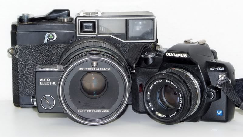

My G690 with the AE100 metering lens and EBC coating. By the way this was the only lens ever EBC coated for the interchangeable lens bodies. Raid, I think this is why you mentioned how good it is for color transparencies, since you have one.
This camera is sitting alongside my Olympus E400 and OM Zuiko 50mm f1.8 lens for comparison. This Oly DSLR is almost identical in size to the Olympus OM-1 camera from the 70's.
I've been through the Oly DSLR line and one PEN and settled on this E400, which was distributed only in Europe. I hunted this down as it is the very last and largest (10Mp) Kodak sensor used by Olympus. It's also only marginally larger than a PEN, yet is standard 4/3 mount, meaning it can use and rapidly focus all the standard mount Olympus 4/3 lenses including HG and SHG. Yet, it produces the great Kodak colors.
