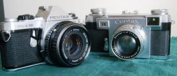

I took a couple of quick size comparison shots (Contax IIa with prewar collapsible 5cm/2 Sonnar, ME super with 50/1.7). As you can see, the Pentax body is slightly narrower. Front to back with a lens mounted, and top to bottom, the Contax wins.
In all fairness though, I rarely shoot the Contax like this. You pretty much need a good shade at all times with an uncoated lens.
Shutter noise: Not much difference; I find Pentax M bodies very quiet. My Contax could do with a CLA, though, so it might not be the quietest there is.
