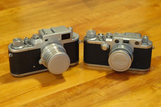

IIIc vs Z3M
IIIc vs Z3M
There is a commonly-held perception that no FSU camera is even remotely in the same build quality class as a Leica. The perception is commonly held because it is true. The Russians used aluminum where the Germans used brass, and used paper shims aplenty rather than careful machining. The thought that a Jupiter 3 is a great lens but of course you need to fix the lensmount shims before you could actually use it at close distances would be unthinkable for Leitz.
All that said, the Russians were also a lot more imaginative than the Leica people when it came to introducing advanced features. The Zorki 3's pioneered a very nice, bright, large combined view/rangefinder, and made an easy provision for adjusting it both near and far, something the screwmount Leica cameras never did. Certainly, the Zorki 3 VF is prone to amusing traits like having its field of view change as you adjust the eyepiece diopter, but for my money, it's a lot easier to use than the Leica VF.
The Zorki is bigger, heavier, and clunkier than a Leica, but gives you a removable back, making it far easier to load than the Leicas. The Zorki 3M even gets all the speeds on one shutter speed dial, and although the slow speed escapement is not particularly well made or reliable, it can be replaced with one cannibalized from a Zorki 4, which is common as dirt.
The Zorki 3's are also a whole lot cheaper of course.
So I guess, if what you really want is something that is mechanically precise, and absolutely a joy to hold in your hand, go for the Leica IIIc. If you want something that looks cool but a tad clunky, is almost-smooth in operation, and a lot easier to use to take pictures, the Zorki 3M is for you.
Me, I can't make up my mind, so I have one of each.
Cheers,
Dez
IIIc vs Z3M
Cheers,
Dez
