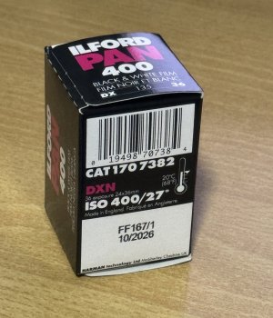

Ilford Pan 400 is still in production currently. Here is one roll on my table (expiry date is Oct 2026):
It is definitely available in the China market as a budget B&W film at around US$5/roll.
