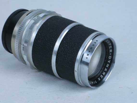

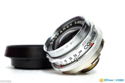

Chris that is part of what I am trying to find out. I thought some people here were bound to know as I knew some old cameras had this arrangement but did not know which and a quick Google was not all that helpful. But I was in general also interested in finding out which ones were good. Two I see come up reasonably frequently are a Voigtlander Skoparex 35mm f3.4 for Bessamatic (Usually going for around $100) and a Voigtlander 135mm f4 Super-Dynarex for Bessamaticwhich often goes for less though I do not think this necessarily denotes low quality - just abundance combined with low demand. Of course I am sure there must be others. My experience of older European lenses of this era is that they are strongly made and optically very good but low in contrast. I have also noted that some of these other Bessamatic lenses command very high prices considering they are for a dead system.
Both of the above named lenses are cool looking lenses. I especially like what appears to be movable depth of field indicators on the first camera similar it looks to the lens.
Peter, if this is the same 135/4 for Bessamatic that I inherited (not sure, don't have it here), the minimum focusing distance is incredibly far, over two meters, possibly 3 (also don't remember exactly). Ans on that specimen the grease in the helical has become stiff. Not keen on fixing it because of the mfd.

I've also shot the Retina-Tele-Xenar 135mm f/4 on the K-01. It looks good, but I found that its image characteristics aren't much different from those of the Takumar 135/3.5, and its close focus distance is, indeed about 3 meters.
