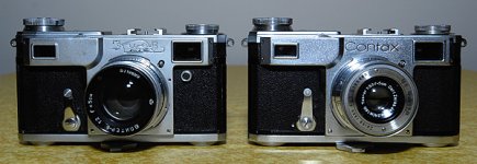

I always thougth that there are almost no differences between Contax II and Kiev II (and also Kiev IV). Few days ago i bought original leather case to Contax II, and it do not fit onto my Kiev IV. Kiev IV seems to be quite bigger. Both cases are almost the same ... but, there is a small difference in dimensios so i can't use it with Kiev.
I've heard that pre- and post war Contax II can have different dimensions ? Is it true ? Or maybe just Kievs and Contax are not equal in dimensions ?

Well i tried 3-4 times and it's really going not so easy to put my Kiev inside this Contax case ... it's a bit smaller then original Kiev case ... Finaly it's possible to put Kiev in Contax case but i would not say that it fits naturaly ...
Any ideas why ? I don't think it's because Contax case is older ...
Maybe i was wrong and this case is not to Contax II ?
few pics (Contax case is smaller - on the left, Kiev on the right):

...that looks to be a post war Contax IIa IIIa ever- ready case.
(...) make sure it fits the pre war Contax body you plan to buy, as this post war Contax IIa/IIIa camera case is made for these post war smaller bodies and might not fit a pre war Contax II.
Yep, that is a !!a (or IIIa) case, made for the post war camera. Which is smaller than its predecessor.
The later Kiev case with the rounded top was a copy of the IIa case; the earlier ones were a copy of the prewar II or III case.
