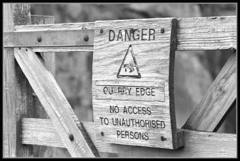

Straight scan of Tri-X negative. No post processing. Get the developing nailed and tweaking is minimised.
