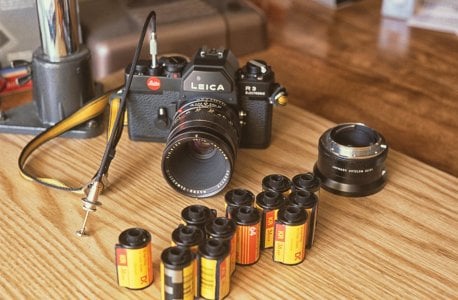

I had a roommate in the mid-late 1980s who taught Jr. High history. At his request I took hundreds of slides of pictures in textbooks using a macro lens. I started with a Nikon F2 and their 55mm macro lens, but I found framing was always off center, so the slides required allot of masking (or often needed to be reshot). So I purchased an R3 and a 60mm macro lens (with the 1:1 tube); with that set-up framing was spot-on perfect. It ended up being a huge time-saver as I only needed to mask slides in order to crop.
The SL I purchased as a back-up was equally precise.
So under these circumstances, which set-up would you say was best?
