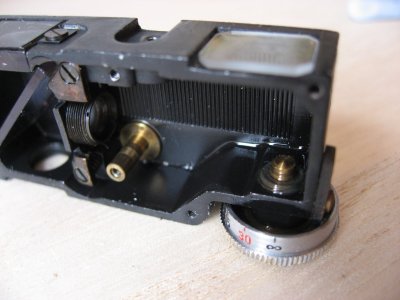

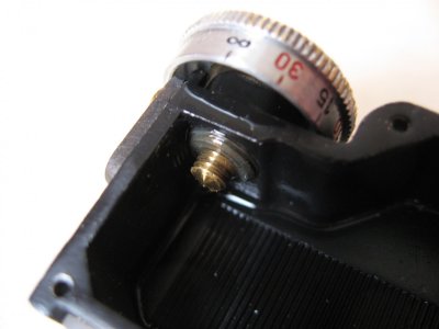

I'm cleaning up the rangefinder of my newly-acquired Agfa Isolette III. All was going well until it came to freeing up the focussing knob which is well and truly stuck.
Despite following the excellent advice offered by Sandeha Lynch and Roland & Caroline et al, I've made no progress. I removed the rangefinder in order to dip the stuck end in naptha, allowing it to soak for 48 hours, but it remains stuck. If I grip the focussing knob with pliers and apply considerable effort the knob will just about move, although it may just be slipping on the inner brass core it surrounds. As the accompanying pics show, this has resulted in scratches and burring to the knob itself.
Any fresh ideas are warmly welcomed - along with any offers to purchase a replacement rangefinder(?)

Hi TenEleven,
Thanks for your prompt reply. Yes, I removed the two flatheads, but these just allow the focussing knob to spin around helplessly. They do allow for the easy removal of the knob, which will be handy when I get around to de-burring it. With the knob removed, I applied a strong grip to the now exposed inner brass core, but it still refused to budge. I also removed the third, outer screw but this is just a stop limit screw.
Regards,
Nick B.

PS you might want to remove the outer wheel (it has 3 grub screws) and work the brass inner wheel only
Yes, I tried that but the inner brass wheel is smooth and difficult to grip tightly enough. The milling on the outer wheel provided more grip, unfortunately not enough to prevent the burring seen in the pics.
Nick B.
