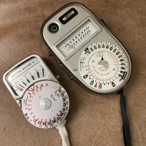

George Melton, Quality Light Metric, who’s unfortunately retired now rebuilt my Weston V a couple of years ago. I guess the cell was ok but he put a new one in, a new perforated flap/cover to adjust for that particular cell, remagnatized the galvanometer magnet and calibrated it. It now works like new.
Although not a selenium cell he rebuilt, converted to a modern cell and calibrated my Weston Ranger 9 which is one of my favorite meters.
