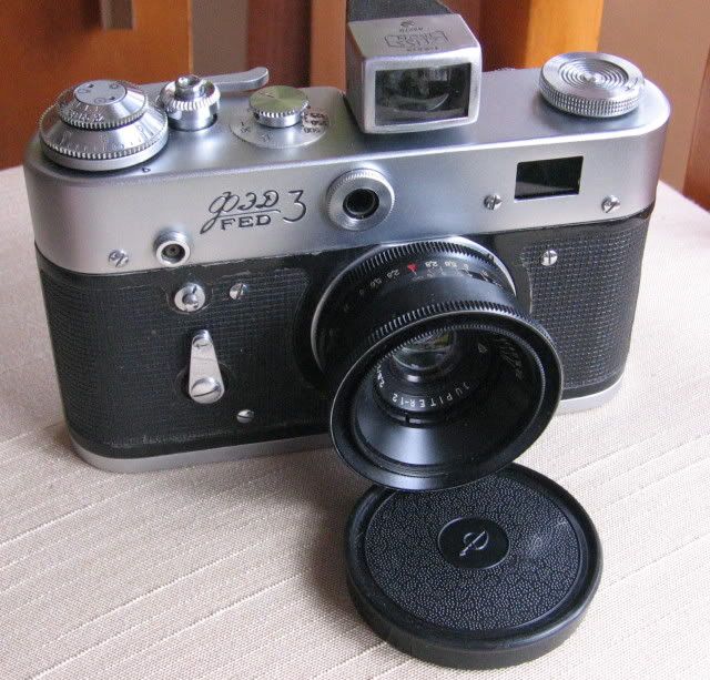

I'm finding myself jonesing for a Jupiter 12 lens and I'm wondering: Are there any fit issues with a FED-3B (lever wind) body? I'm still new to the FSU cameras and I'm curious about the amount of lens that protrudes past the mounting threads and into the body of the camera. Can anyone enlighten me, please? Thanks in advance.

It will fit in. The only issue with this lens sometimes is with RF arm. Needs to be bended little bit to make RF focusing work.
It isn't difficult and other lens will work after it as well.
wolves3012
You shouldn't have a problem using the J-12. As said above, sometimes the RF sensor arm needs a little help but it's most commonly a problem on the FED 2, for some reason. The lens will fit on all the FSU cameras, there is no problem with the bulging rear element. Just take care not to scratch that rear element with the RF sensor arm as you mount the lens.

With my FED3b I had a problem when trying to mount the J12 lens, the RF arm stop on some models is to long (about 1 mm) and will scratch the border of the rear element in infinity position. I had to grind down about 1 mm to be able to mount and uses the J12 with my FED3b. This problem does not appear with all copies of this camera and is related to the sloppy quality control.

No problem, a very good combination!
