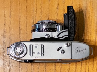

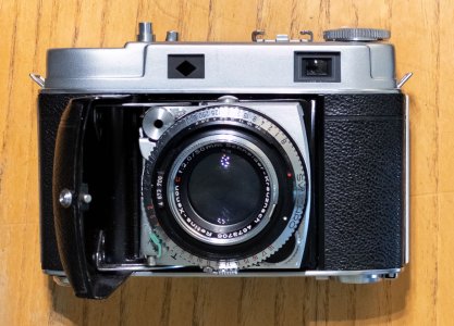

A couple of years ago, for reasons that are too crazy to mention, I bid on and won four Kodak Retina IIc cameras that were being auctioned as "not functional, for parts only". When they arrived, what I found was that *all* of them were reasonably functional, despite being full of dirt and dust from sitting in someone's sock drawer for thirty years, and even though two of them had been dropped and bashed several times. I had two of them serviced and cleaned: they're like new now. A third of them was my donor camera for the slightly crazy project I acquired them for. The fourth is sitting in a box waiting for me to decide whether to give it to the repair shop (either for refurbishment and sale, or for use as a donor camera) or have it refurbished for my own use (even sillier because I now have four of these cameras in perfect working order...).

The Capital Gang. IIIC: was missing the front element, replaced with one from a parts IIIc. IIC- replaced cocking rack. 1B- CLA shutter blades.
The IIC: the Aperture opens up to F2 on this one. The rear group is the same as the 50/2 Xenon. SO- mine is now an F2 Xenon. Works perfectly.

It arrived the next day. Did a few rolls of film with it, no functional problems other than the meter and the dented top.
... Thinking to myself: 'Hmm. The IIc and IIIc are virtually the same other than the top cover, the meter, and a couple of supporting bits for the shutter release and such. I wonder if I can find a IIc with a good top cover and transfer the bits to the IIIc and get the f/2 lens ...?'
And it went from there. What's crazy about it is all that work and expense to create another IIc when I have three others, but this one with the f/2 lens.

I have the same collection of accessory lenses for the Xenon originals. All the lens numbers on the 50mm lenses match on all my bodies. There's one IIc body (early serial number) with a ten-leaf iris vs all the others with five-leaf irises. The ten-leaf iris body has a couple of other minor deviations from all the others as well (design of the aperture/EV ring and indicating pointer).
