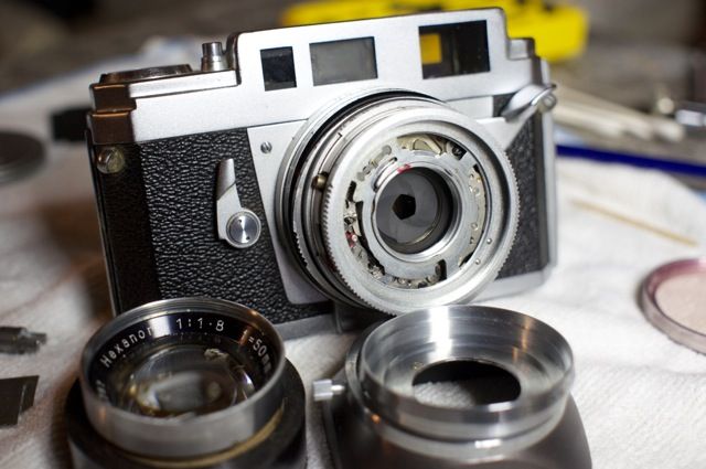

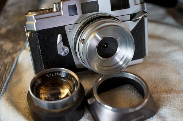

Bingo!!! Frontman is the Man of the hour. Yes indeed. It screws right off. My problem was that I completely missed seeing a tiny
set screw positioned perfectly between the engraved Seikosha . MXL... I mistook it for part of the engraving.
Anyway, thanks so much... I'm on my way in. Wish me luck. :angel:
