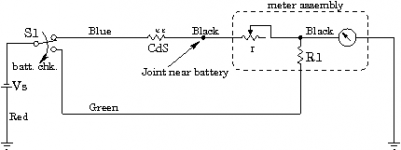

Also, does somebody know the circuit diagram of the metering circuit of this camera?
Thanks.
Circuit as requested. The black wire tab is just a tie point. Its not uncommon for the switch contacts to become faulty. I think if you remove the screws the case can be pried apart and the contacts cleaned.

I am trying to restore an Autoreflex T to working order and this forum has produced the most helpful info that I can find.The schematic up above is the kind of documentation that can be a big help when troubleshooting the low voltage ailments that seem to be common in this model of the Konica line.
I wonder how close that schematic is to the model that I am working on?
The battery compartment contact failed early on and I repaired that and also cleaned the test switch which didn't seem to help very much.I see some suspect solder joints which I intend to touch up today.The variable resistor and the fixed resistor in the schematic have different values than what I am measuring on my camera but I assume the basic circuit is the same.
I am getting battery voltage to the on/off switch but it sure would be nice to know what the circuit looks like while I am working on it.

Now that I have my camera repaired I found a website with a schematic to it which I will post here for you.
http://silvergrain.org/Photo-Tech/Konica-AutoreflexT.html

Interesting information here. I checked my Konica Auto S2 and disassembled the meter. The circuit that I noted is given in the attached file, it is same as has been posted here earlier. In my camera though, the variable resistor r was set to 7.8 Kohms (I think its max value is around 12 Kohms) and the fixed resistor R1 is 9 Kohms.
