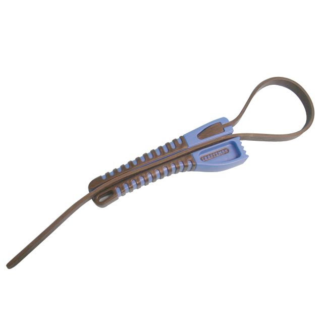

For future reference, I use a strap wrench to handle stuck filters. Other devices have been devised, but this tool is the one I like the best because the rubber material is safer in practice, at least in my hands.

Trius, thank you for the pic. The link appear to be for something else? But anyway, one more in the list of tools to get...
