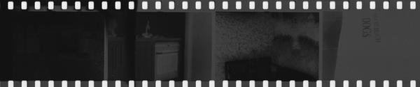

I checked the negatives and it continues onto the sprockets and stops where the vertical band on the second image stops.
I attached a scan of the negatives (hope it's clear).
I attached a scan of the negatives (hope it's clear)....
Very interesting fogging pattern. The pattern proves two things:
1. The fogging did not occur as a result of a shutter problem because it continues onto the sprocket area.
2. The fogging did not occur when the fogged portion of the film was wound around a spool, takeup or cassette. If it was there would be both some faint "echo" of the fogging on subsequent lower layers and there would be denser fogged patches were the sprocket hole on the top layer allowed unreduced light to hit a lower layer. This means that the fogging did not occur as a result of a fault in or damage to the felt lip on the cassette.
The pattern indicates that the bottom of the camera was disturbed while the camera was wound to the first, leftmost in the scanned strip, frame, either just after loading (opening the base and realizing the camera is already loaded) or after rewind (opening the base and seeing that the film wasn't completely rewound then closing and finishing the job). The dense fogging on the next frame along with the characteristic edge shape produced by the felt lip supports this conclusion.

It didn't happen after rewind, because the film was completely inside the container when I opened the cam.
Then I must have opened it just after loading. I can't remember doing it, but it doesn't mean that I didn't.
After all the stories I heard about how difficult loading a bottom loader is, I was a bit nervous. To my surprise triming the film and loading the camera wasn't that difficult.
