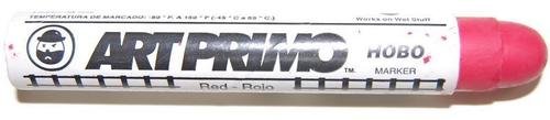

For those of you who may be looking at this thread in the future, I've discovered what Youxin was referring to. He's very responsive!!
http://www.ebay.com/itm/37164963436...49&var=640636351039&ssPageName=STRK:MEBIDX:IT
"ART PRIMO - HOBO MARKER - SOLIDIFIED PAINT STICK MARKER"
attachment.php
In the appropriate colors, these are excellent for restoring engraved markings on lenses and bodies. They last nearly forever. I have a white one that I've used off and on over the last 30+ years.
I'll bet they look really cool in that shade of pink.
Thanks for the suggestion! I touched up a Summitar and the IIIf top plate with fantastic results.
