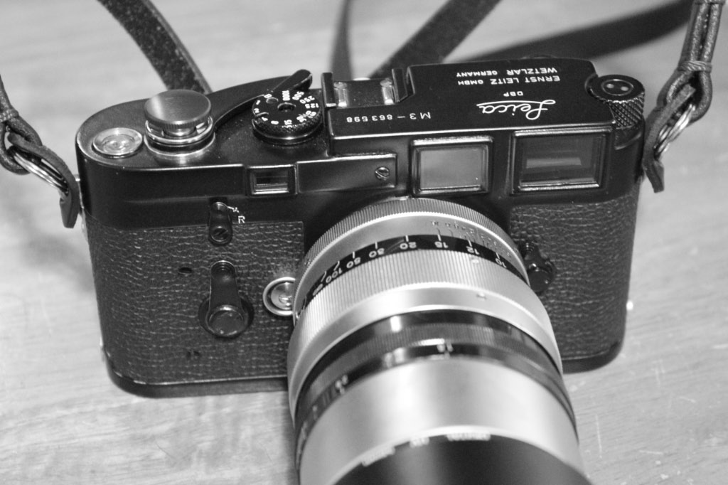

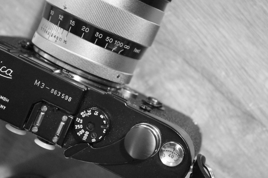

I am wanting to change out my chrome shutter speed dial and my chrome preview lever for a set in black paint. The shutter speed dial is just the one screw, right? How about the preview lever? I have a spanner tool that will fit the two holes...is it just a simple matter of un-screwing? Anything special to watch for? Should I let a pro do this
Vickko
For the shutter dial, just one screw. I think the middle of the dial is chrome, is that right? If it is black, it is a little plastic dot.
For the preview lever, it is just the lock screw with the two holes. It screws off counterclockwise. You might want to drip on a tiny drop of lighter fluid on the screw, before you loosen it. It will dissolve any corrosion that might be there. I hold the lever when I'm loosening / tightening the screw, to not transfer the force onto the preview mechanism itself.

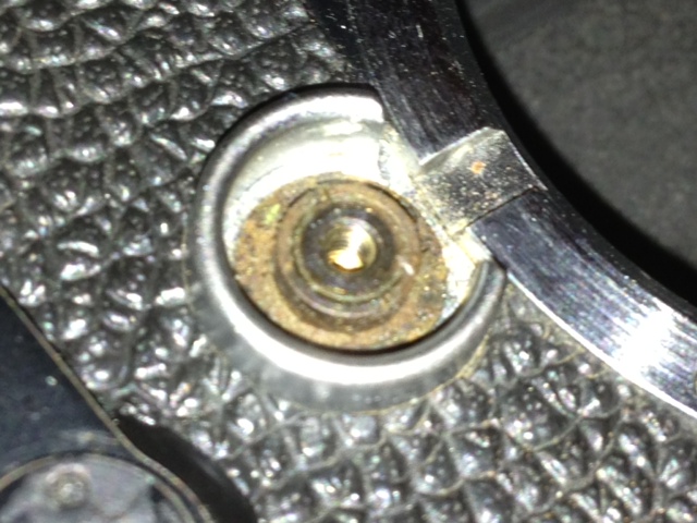

Got it- both parts were easy to un-screw. Should have the new black parts later today. My new issue is with the screw in the center of the lens release button: I can't get it to turn! I'm replacing my lens release button and guard ring for the later slimmer version so I can fit larger diameter lenses like the canon 85mm f1.5....any advice on removing tough screws? I don't want to tear it up!
Vickko
That screw should be a normal right hand thread. Start with dripping lighter fluid and oil into the screw and let it soak. Use a screwdriver that fits perfectly.
And I mean "perfectly". Hone the end of the screwdriver if needed. And use a screwdriver with a large enough handle.
And one trick is to "turn the screw clockwise just a bit, and then counterclockwise to unscrew it". But tricky because if you do it too much, well, the screw breaks.
In case you get really stuck, DAG in the USA sells Leica parts. www.dagcamera.com
Good luck

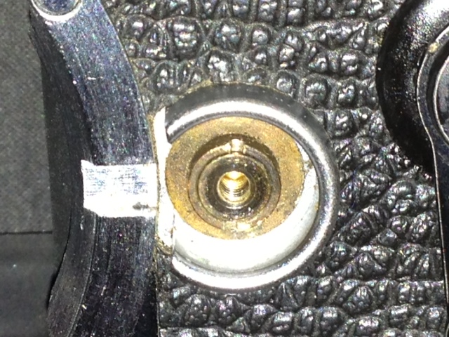

Got the release button loose! Had to file a screwdriver to the proper size...
Now what? Spanner to release ring that holds guard?

I only have an extra button and an extra guard/collar. I don't have the internal part. I'm more concerned with what comes next- how to remove the guard
The guard is held in place by the internal part which unscrews easily. You just need a two pronged tool that fits into its slots.

Sounds good - I will give it a try.... So no internal access is required? When I get the retaining ring removed, will there be any springs or washers to watch for?
Thanks
Thanks
No internal access is required (assuming the design is the same as the Leica MP).
The spring loaded nut should come out as one unit. There's one light seal washer between it and the body.

Made a brass tool to remove the part but it is too soft- won't turn. I'm being VERY careful, but I think it's time to get pro help!
It should be easy to remove with the right tool. Have you checked the Micro Tools website? They have a good range of tools for camera repairs.

I think this is what I need:
http://www.micro-tools.com/store/P-179/45mm-Minispan-Wrench-Blade.aspx
cassel
No luck- tried making a tool with steel and it still won't budge. I gave up because I don't want to damage it. I will take it to my local tech.
