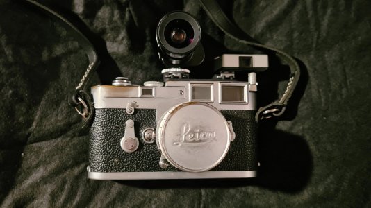

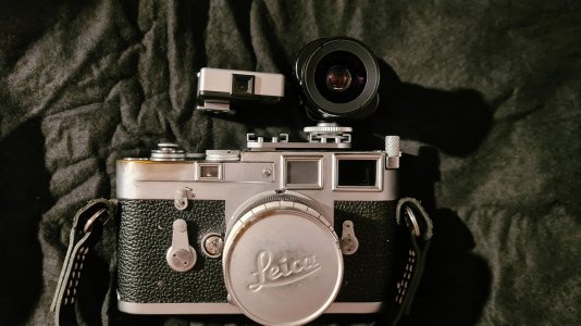

I attached two fotos of my setup to clarify. You can probably see that the meter won't fit when the finder is on.
I know that it is possible to change the position of the meter's foot, but obviously not as far as necessary.
I'll keep looking for a solution. In the meantime, using the VC2 hand-held, or my Sekonic, is not a bad idea at all.

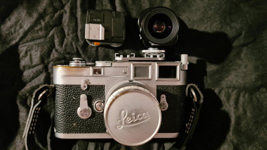

Got myself a 3d-printed wider double shoe adapter from the US. Now my finder and meter can be used alongside. See attachment.
For anybody out there who has a similar problem, please visit:
