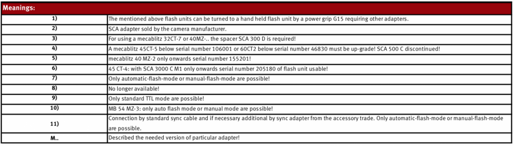

Here's what the Metz brochure says--are the particular models you were looking for contained here?
Oh, and you'll need the explanation for the numbered notes:

Do you know what METZ models that work with all the capabilities of an R8 or R9?
The 54MZ-4 works with both and enables TTL, but you have to have the SCA3502 module plugged into the flash. These days, the module is probably harder to find than the flash. This model looks like a traditional on-camera flash and has a very nice build quality. I got it back when the 54MZ was in current production.
