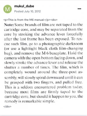

See Mukul Dube’s response in this thread:

Raydm6: Thank you for this. I should have resorted in the manual but didn't think of it. I will try this " remarkably simple" remedy in the changing bag and report the results here!
I knew I would get some useful ideas here, as always!
Thanks again also to mukul_dube for finding this!

Update: I had to resort to plan B (turn on the lights like Mackinaw ) to find the end of the film, then return into the bag, retrieve, and load it to the tank. The recommended method from the M6 manual (see above in this thread) did not do anything for me despite many attempts.
