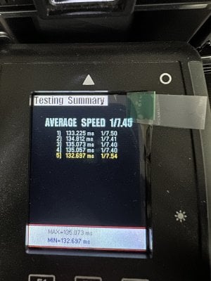

Before loading my new R6 I gave it a quick check to see how accurate the shutter was. Turns out it is still quite accurate and very consistent. For example, at 1 second the deviation over 5 shots was only .02 of a second.
