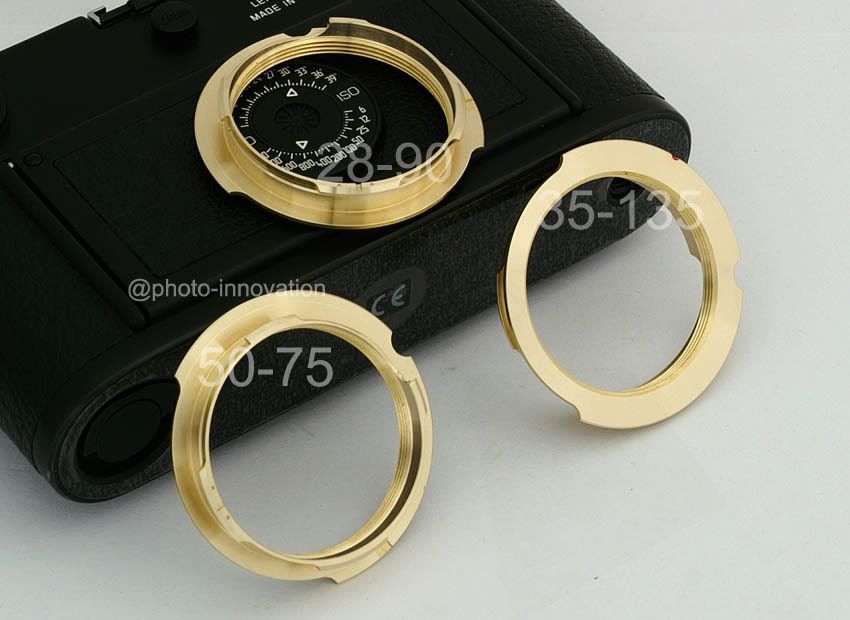

mirrored
Have you experience with brass colour chinese one? I bought serie of three for a different frames and I am waiting them. Just now I don't find any similar on Ebay and I think are they failed ones and stopped manufacturing that reason... if they tend to take root without chrome?
Maybe I need vaseline.
http://i7.photobucket.com/albums/y2...adget/BASINGSTOKE-CAMERA/leicamadapterset.jpg
The seller was in GB and the serie cost 35£ with posting. I supposed them chinese, because similar was in HK seller too.
John Lawrence
The one I got was chrome (possibly chrome over brass - but who knows???), but didn't bring up the frameline. Also the machining was dreadful, really rough but then I didn't pay much for it!
In the end I purchased a Leica one second hand which works perfectly.

I also ordered the brass coloured Chinese set, and they seem to work fine. The 35-135 doesn't quite bring up the frameline cleanly on my Hexar, there is a little bit of the 50 framline, but it does the job. I think the truth is, if you can afford the Voigtlander or Leica versions, you will get ones that work properly. Any other maker, there is a certain amount of gambling.

I have seen most sheap ones too mentioned be brass with crome surface. I was not worried gambling with so little money when brass is easy machined if adapter don't work properly or are poor finished. Thus it need certain know-how with framelines.
