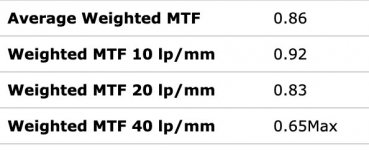

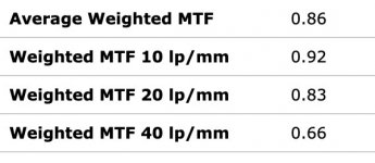

That site only tests MTF at infinity. Look at the other MTF scores....
Konica M-Hexanon 50mm...
Leica Summicron-R 50mm
So the statement about "There is no way, objectively...." is a little suspect. Esp. when you already mentioned one "Maybe it was one that was not calibrated for M bodies correctly?"
