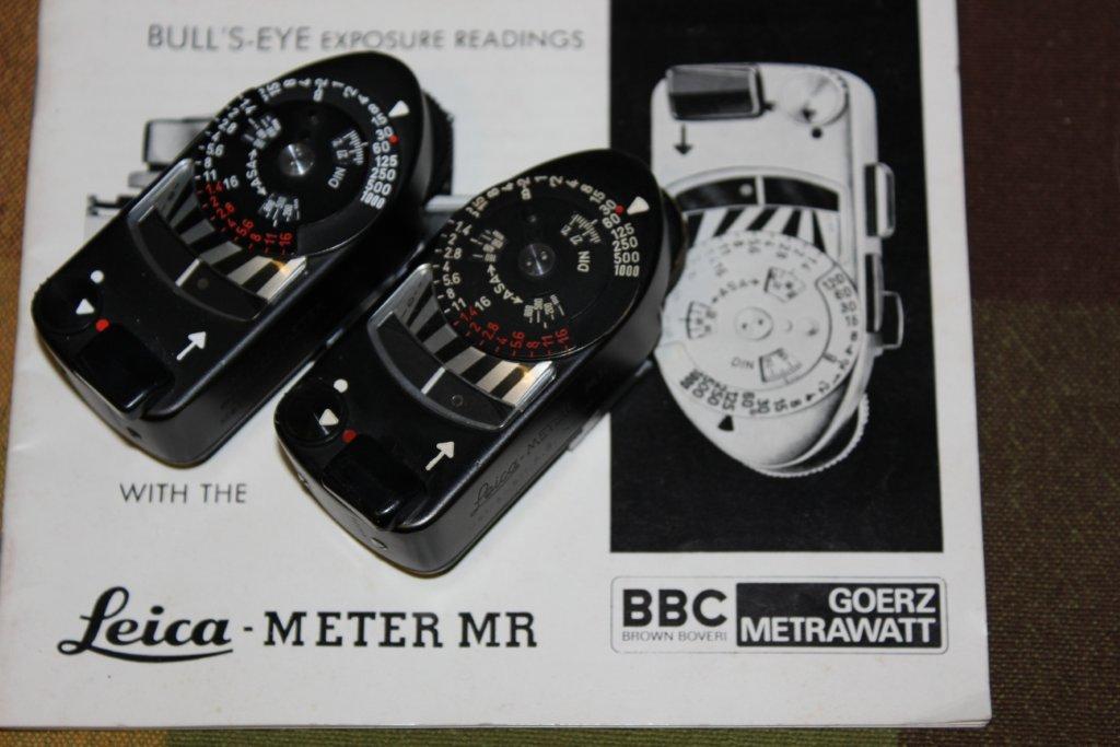

Just picked up a MR-4 meter for my Leica M4-P. It looks to be in good shape but I'm having trouble with batteries. It was sold to me with the MR9 adapter that allows me to use the 386 (SR43) battery...it's supposed to convert the voltage to 1.35 and makes it the right size. The first 386 battery I tried lasted about 3 days. Seemed to work ok, but this morning it's dead. The battery test button is erratic- jumps around and sometimes settles on the correct spot- sometimes not. I put another-different brand-new 386 in it this morning and it seems to be accurate again. The test button is still acting strange. I also have a Varta v625u that I tried and it is too high a voltage- but it does fit and works OK.
What should I do? Accept that the test button is not working right but the meter is OK otherwise? Try the new battery for a couple of days? Take it back and get it repaired or refunded? Send it to Quality Light Metric? Buy another one? Buy a Wein 625 cell?

Now I have two of these plus a supply of Wein 1.35V cells. The new one works fine- matches my Luna Pro SBC right on the money. I will try out the old one with a Wein next...but I suspect dirty contacts/faulty test circuit.

BTW I just tested the 1st MR4 meter with a wein cell and it is about 2.5 stops off from my Luna Pro and my other MR4. Plus the battery check function is still erratic.

Just got off the phone with Doug at Camera Clinic in Shoreline (north of Seattle) where I bought the first meter. He wants me to bring it in for him to have a look at it. Not gonna make it there today, closes at 2pm, but in the meantime I will test the 2nd meter.:rolleyes:
Took my meter to Doug last Saturday and he will adjust it to be a bit more accurate. I just got back a test roll that uses the old meter and the new meter: the results were confusing! Exposure looked ok, pictures that I thought would be underexposed looked ok, just a bit dark. Not that different from shots with the new meter. Negs look a bit thin so I'm guessing the lab made corrections. Hopefully I'm not wasting time getting it adjusted. I know that the meter was NOT agreeing with my known accurate Luna pro...
Got my meter back from Camera Clinic...it is exactly one stop off from my other meter. I know that my Luna Pro agrees with the second meter. Oh well, I will continue to test and figure out how to best use the meters. One irritating habit of the second meter is that the film speed setting gets bumped/changed going in and out of the bag...it's made me miss a few shots.
