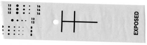

Well... Every day is a learning day! I salvaged the backing paper and here's the end of it. Never noticed this before! It is pretty obvious that the light leaking onto my 12th shot (centre numbering) comes from that passing through this hole and bleeding out as I wind the film off with the red window unshuttered.
It is also obvious by the circular and regular bleed-out pattern that the 'ruby' (orange) window is where the light is getting in.

I would be cautious about inking in your red window. With panchromatic film, the film would be exposed through that hole in the backing paper, even through a red window. The only way to avoid light leaking through the hole and causing the black dot would be to completely block the window while winding past it. Intact film backing paper should block any light coming through the window, even if the red glass/plastic is degraded (although light could still bounce around inside the camera, I suppose).
I'm not too fussed about the black dot, as it only appears after the last frame, likely with me winding the film off with the red window open. It appears on my Baldixes and is neat and well defined. But on the Franka there is a distinct bleed-over which encroached onto the last frame shot (frame 12) so I had to do something to mitigate against stray light.
I think that has been happening on some shots, as described in my original post. The pressure plate is matte black both sides but I may stick some 35mm SLR type light-sealing foam behind, between it and the camera back and see if that makes a difference.
