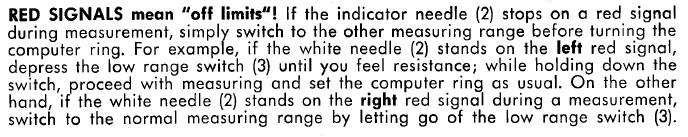

kiemchacsu
Hi all,
I got a Gossen Sixtar light meter, it's pretty good for out door metering but for in door I am quite frustrated, I read the instruction but still couldnt manage how to do in because the term "until you feel resistance" is quite vague because the needle movement is depended on how hard I push the button. Can you guys show me how you handle to use it in indoor sitution.
Thanks for all help.
Cheers,
Trung
Cheers,
Trung

Roger Hicks
Dear Trung,
Sounds like an elderly and poor electrical contact -- possibly caused by oxidation, possibly by an earlier owner not being too sure what 'resistance' meant, and pushing too hard... Unless you want the meter repaired, I'd just push a little harder.
Cheers,
R.

Richard G
Trung, i have e Gossen Sixtar bought in 1977 and still working. You push the button until you feel a resistance and suddenly the needle moves from the left to take up a new position in the low range read-out. Pushing further locks the measurement if it's too dark to see. I think this meter is called the Super Pilot in the US. I now use the Gossen DigiPro F with the swivel incident cone. Great for carrying in a jacket pocket where it is tall enough to be retrieved quickly. I like to get a reading before moving the camera from under my arm. I tried an iPhone app but it's no good for quick surreptitious readings. What you use the meter for exactly really does determine what meter to get.
